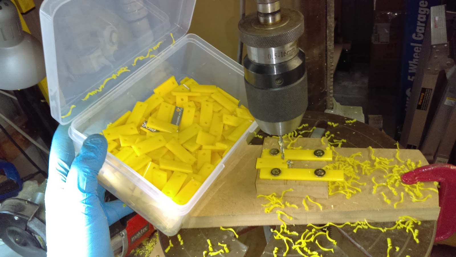

    I made some balanced line a year ago or so... maybe a bit more.
    I'll try to post some photos, there we go:
    https://1.bp.blogspot.com/-IWLiHTit5...55B1%255D.jpeg

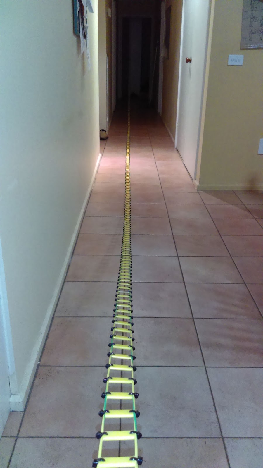

    Measuring the velocity factor and impedance inside the house, and having it cut to 14.200 (it is for a G5RV)
    https://2.bp.blogspot.com/-FRzWeL9oZ...01-WA0036.jpeg

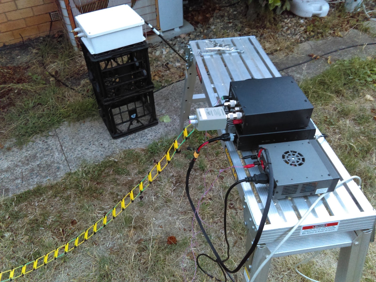

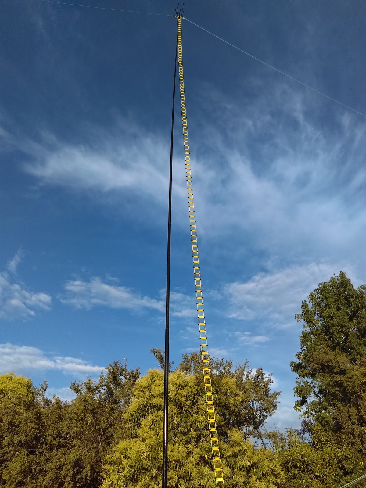

    And this is how it looks when in use:
    https://1.bp.blogspot.com/-zdLZHVHQb...0/IMAG0313.jpg
    https://1.bp.blogspot.com/-9paDrlZKN...0/IMAG0315.jpg
