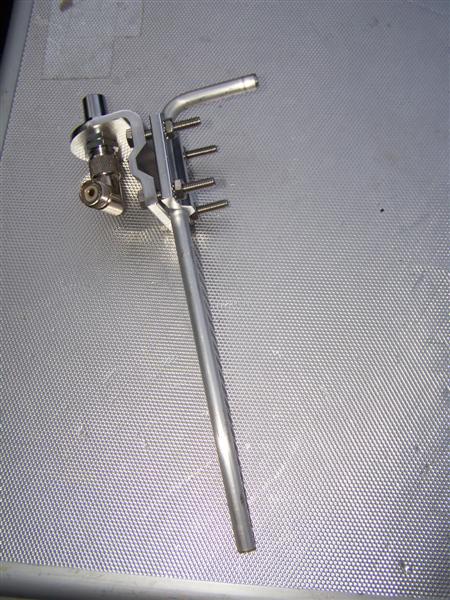

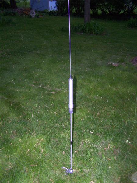

    Thought about ordering a stake mount from Blue Star Antennas until I added up the final cost. $22+ was a bit much. I took the 3/8x24 mirror mount off my backpack frame, cut a length of solid aluminum rod, put a 90 degree bend near the top and made my own stake mount. I planted that, screwed the MP-1 to it, tuned and checked in to the MMSN on 14.300 to check it out. Got a good report from the net control station in NE.
    Since you guys like pictures, here you go. I didn't bother with the telescoping whip for the MP-1, I just used the top section of a 40M hamstick I had out in the camper.
