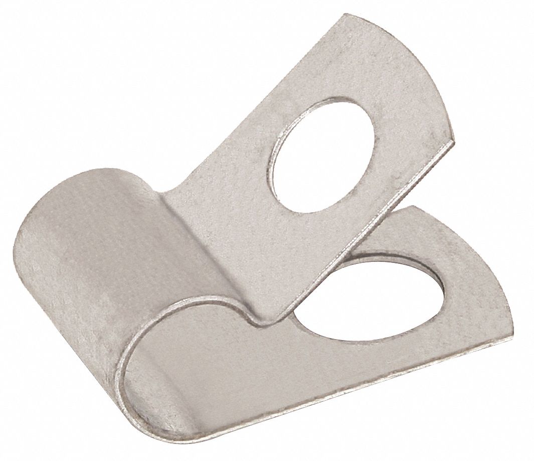

https://static.grainger.com/rp/s/is/...AS02?$smthumb$If you can find them in the correct size, you can also use these things. Put a ring terminal on the conductors, then attach that to the screw (stainless steel is best) that tightens the clamp.
The advantage to the last two methods is that they allow for feed point adjustment when it's needed.
